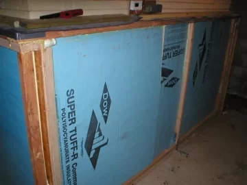

I have a basement served only by an interior stairway which severely limits what can be brought down. I chose to build a 1K gal. rectangular tank. It consists of 2x4s, 3/4 plywood, deck screws, polyurethane glue, and some steel angle hardware. Everything is available in HD or LOWES except the EPDM. The tank has been running 1 1/2 yrs........so far so good. I allow the top of the tank temp to swing between 140 and 180. I also have a forced air system which cannot really use water below 136-140. I've included a picture, and a website that I used as a guide. Polyisocyanurate is the insulation. I put 6" on top 2" inside sides and bottom and 3" outside sides.
http://builditsolar.com/Projects/SpaceHeating/SolarShed/Tank/Construction.htm
