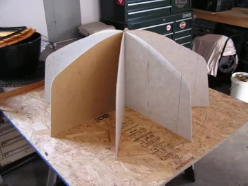

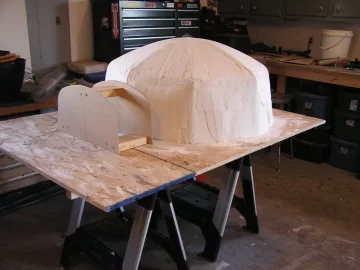

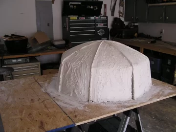

finished the countertops, decided to stain them before sealing them. colors were blending together to much. applied stucco to interior of wood storage area. started mold for castable refractory dome. made templates for shape, mounted them to 3/4 osb flooring. wired them together and added screen. covered with burlap soaked in plaster. continue to build up with plaster until proper shape is reached. I think two more coats will do.
