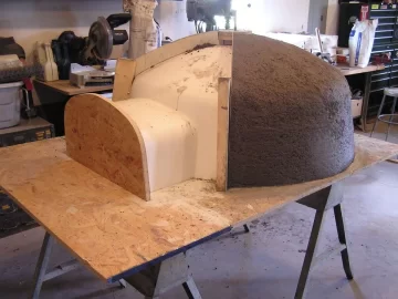

well had some time to cast most of the dome this past weekend. taking longer than expected, letting each section cure 24 hours before disturbing. cast first section Saturday morning then the next two Sunday. will finish it up tonight, had to pour a concrete slab last nite.
![pizza dome refractory casting almost done pizza dome refractory casting almost done](https://www.hearth.com/talk/data/attachments/73/73594-0f46b73c41518e47dbaec1a382dab470.jpg)
3/4 of the way around now
![pizza dome refractory casting almost done pizza dome refractory casting almost done](https://www.hearth.com/talk/data/attachments/73/73595-328e13c4a3452cc0d7a0baa54c37ee48.jpg)

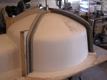

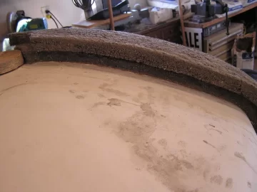

detail of the interlocking dome
![pizza dome refractory casting almost done pizza dome refractory casting almost done](https://www.hearth.com/talk/data/attachments/73/73596-b18dd64625795a3ce5b91d89bceafc8f.jpg)
ready for the next section
