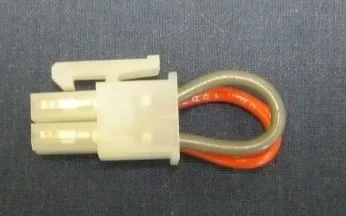

The board that Travis uses has reporting functions via the four wire molex on the back of the circuit board, directly adjacent to the larger 8 wire molex for the components. If the smaller molex has just two loops that are contained, like an orange wire and a gray wire that just loop back to the same molex (looks like a jumper) then the board has so reporting per se, cause the jumper creates continuous continuity. If you have this jumper and are getting errors then either the board is bad or the jumper is loose.
If the jumper doesn't exist, then the gray wires will loop out through the vac switch and the orange wires will loop out through the high limits. I'm guessing you have the reporting loops through the switches and that the nipple on the vac hose is clogged and therefore the vac switch is not closing at start up. Check it out.
Jumper loop
