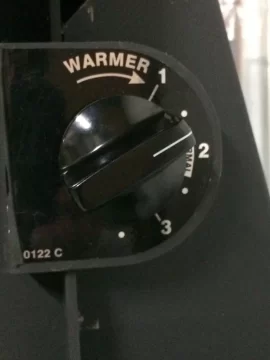

Kenny thanks for the reply's and all other too! Will this insert TOS temp 500 while turning t-stat down to low and the cat is active at the gauge window cracked and flame then goes out (not sure correct word to use} build up of smoke that ignites inside the box with a boom? Old slammer did this scared us when it did. Sometimes I look up at the cat and it doesn't glow but other times it will glow bright is this operator error?

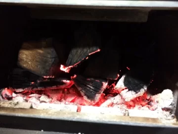

I visited the dealers showroom floor they have a princess stove with a hot fire going with tall flames t-stat set to 2.This is where he leaves the setting for an all day burn. I know why now (flames sell) When I purchased the insert I was sold by the heat output of the princess and the expert advise he had. After reading Kennyp post I know I need to turn the t-stat lower to get my long burn time. When turning t-stat down to a smolder setting 3-4 (FLAMES OUT) I did see small flames igniting before the smoke enters the cat and the cat glowing red hot (hot coals small load 2 splits of red oak) does this sound correct? I just want to load it up set it and walk away for a few or hit the sack with out worry!

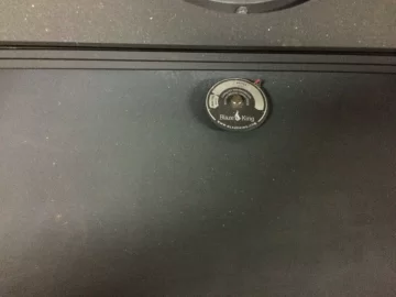

I going to add to this 3-4 setting flames out TOS 550 look up at cat glowing red(temp of cat at the extreme right and climbing) Now do I TURN the t-stat down to prevent over fire or go polish my hot-rods?
Go polish those hot rods, the idea is to find your sweat spot, no flames or a few secondary flames are were you want to be, your cat prob will be in the 2 -4 o'clock at first since its new and considered over active, once the cat starts to settle you'll see the cat hang any where from 10 to 2 o'clock. Again these stoves are to be considered the most boring stoves out there, faint glowing fire box (if you have clean glass) to a fully covered black glass, active cat during all of this is how you know your doing it right, if you need more heat simply turn the t-stat up for more air, nothing is wrong if you need more heat and you got flames in the firebox
Well now learning to burn more with less air thanks to this forum! ? Do I load the fire box up past the fire brick inside to insert.? Stove cruising TOS 550 Combustion dial temp at 3 oclock and raising to almost the black area of the dial. This time I have Red Oak burning and did a top down fire then turning slowly till coals are bright very little flame.I did activate combustor just as the dial said Fans too.Insert working great excellent heat but.How do I control the catalytic dial to the safe zone It seems this temp keeps climbing. Does opening up the draft till I get flame then open up the combustor till cat temp goes to the safe zone or go out and polish my hot rods lol
Your not going to control the needle to the safe zone due to it being an over active cat, no worries with that either as long as you have the T stat set and you have no flames to small flames in the fire box, over time the cat will break in and settle.
