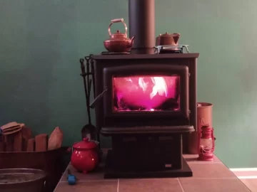

I am brand new to wood burning. Purchased a Pacific Energy XL 27, installed on November 22, chimney and all by professionals. Like your set up - the chimney is straight up through the roof. My home is 1000 sq. feet as well, and this stove is more than enough to do the job. I was concerned it would take me a while to learn the tricks of using a wood stove but this stove is so easy to use I had it down in a couple of days. I researched much here on this website and really found no one unhappy with Pacific Energy. I am using the stove top to warm up my leftovers, and provide hot water for tea, as an additional bonus. When I stoke it well before bed and turn the damper all the way down, I wake up to a warm home and a bed of hot coals to get it going again for the day. I could not be happier with my purchase. I am finding that my evenings are spent relaxing and reading by the fire, whereas previously I was always inclined to continue working at night. Therefore it is great for my well-being.
