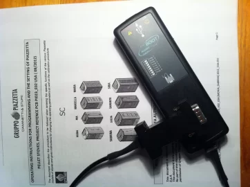

well this time the boot loader is to reset a stove but not has the default settings but to a full setting I'll try to explain
this is a boot loader you plug this in the back of the stoves so you can unlock all the settings

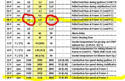

now whats about it, well has you can see in the next image I have circled settings 2.0 being the minimum and 12 is the maximum adjustment for pellet feed
that's is true in the tech book only, in real life the stove default adjustments are way less permissive if I remember at Power level 3 you only can go from 5.9 to 7 ( time feed ) but what if you need more or less in an other exemple the combustion blower settings are from 1500 to 2800 rpm but by default at level 3 will be from 1750 to 2300 if you need more you cant unless you have this little boot loader to expand all setting and it gets very fun when you have different configuration example; using energy saver or not, or I had a customer who wanted to run is stove on solar system there a way to never stop the stove just like those thank stove, but to bring it down so much you wound believe there is a flame in there. anyway they are so many adjustment I can do whit a Piazzetta it almost unbelievable that people are having problem whit this stove it's now my third years whit Piazzetta many sales and all of our customer are very satisfied whit the product and it as to stay that way Mont-Laurier is to small for customer problem. sorry if I offended you but if you sale and install Piazzetta I remain whit my opinion.[Hearth.com] Piazzetta  - some advise and little secrets you would like to know
