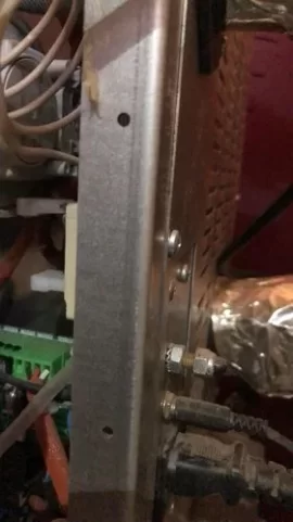

There is usually a manual reset button, for the hopper overheat safety thermostat, located on the back of the stove, sometimes under a black plastic cap. Look near where the power cord plugs into the stove back. The black plastic cap usually unscrews, to reveal a red reset button.

usually, but not on a Piazzetta. They reset when they cool down by them self, the only case I had to deal with, ended in replacing the part.
The Piazzetta Monia Service manual shows a reset button on the back. See page 7, item #21.

Outch.... Please let me validate this information, could be on the 2.0 model only. I should have the info by tomorrow !
there is no reset switch on North-American models! the manual you are referring to might be for European model!
