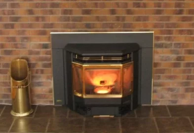

I have two quadra fire classic bay 1200 inserts and have for the most part been happy with them. I purchased them two years ago and am diligent about the regular maintenance as I usually burn about a bag a day in each for 5-6 months of the year ... Canada is very cold!!!
One of them has recently started making a persistent metallic squeaking noise and I wanted to see if anyone else has run into this problem. I am wondering if maybe I have to clean the combustion or convection blowers (manual says to do it once a year but doesn't tell you how and I am a few hours from the closest dealer. Anyone else have a similar problems.
The noise is not like the usual metallic bumps or sounds but can go on as long as a few minutes on and off and usually only starts when the fan is blowing.
Pellet buddies of the world unite ... any tips???
