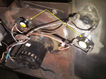

There is an F140 Fan Limit Switch to protect the stove from overheating. I suggest changing or checking that to see if it is still properly connected. Also check the combustion fan and convection fan to assure they are working and still connected.
See pic below. Fan Limit switch shown by right arrow under the high limit switch in left side of stove.
