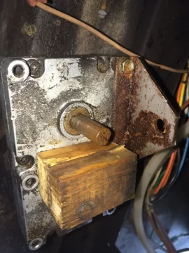

3. Cut 2 pieces from a 1" x 2" pine trim board approx 1-7/8" long. The wood should fit between the screw holes on the front of the auger motor gearbox.
4. - 5. Using a small pry bar and hammer bang the motor off. Use no wood then 1 piece and then 2 pieces as the gap gets wider to get the motor all the way off. Pry the motor from below the auger shaft and above the auger shaft so it comes off evenly. Also bang the auger back up and spray the PB blaster a few more times. It comes off faster this way.
6. Auger motor is off! - See rust and wood pices
