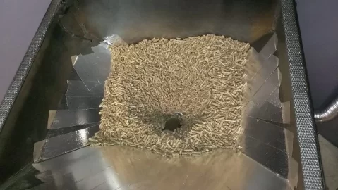

Good morning all. I have had a reoccurring problem with both my previous (Winrich Dynasty) and current (55-TRPAH ie. Englander 25-PAH) stoves. I'm burning Heatr's pellets from my local Home Depot. They burn a bit ashy (and really tend to white haze the window glass in short order) but put out decent heat.
I've attached a picture so you can see exactly whats going on - the pellets are creating a "sink hole" around the auger and starving the stove, causing it to run cooler and cooler, until it actually goes out completely. It would do this exactly the same on either stove, with either a half bag in there, or full to the lid. On the PAH I went ahead and applied aluminum tape to the sides of the hopper in an effort to reduce the drag on the sides of the hopper and encourage things to naturally fall down to the auger - this didn't help much, if at all.
Now, I'm going to try a test with a friend, we're going to trade a couple bags of pellets as he doesn't have this problem, and see if the problem follows the pellets, or stays with the stove. As it's already been both stoves I've had, I suspect the pellets. What do you guys think? Any tips on how to alleviate this problem?![Pellets not getting to auger - is it the stove or the pellets? Pellets not getting to auger - is it the stove or the pellets?](https://www.hearth.com/talk/data/attachments/147/147251-9f38f4d5eb5a4b76ba0ed9f28309db29.jpg)
