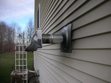

The third is the outside portion of the pipe. It's making my siding dirty. Is that normal or indicative of more issues if its making the siding dirty like that?
I forgot to mention I'm on a hill and it gets windy up here. Not sure if I should take wind factor into account. Does it affect the performance of the stove if it's windy out? Okay, I'm done with stupid questions. Thanks for all the help!

Ok, a few things.
First from the vent cap it looks like you have done a lot of burning with a poor damper setting.
I would pull that termination cap and suck out all the ash from the venting and tee using a leaf blower. Be sure to snap a picture of the screen on that cap so you can share it with us.
Second you should never vent into the prevailing wind, if you are and you've had a lot of wind with strong gusts heading straight at the termination cap it will act exactly like a poor damper setting would and would be random in its effect.
Third, if you are venting into the prevailing wind you have a few choices, they are:
1: Change the vent direction and size,
2: Move the stove to another side of the house.
3: Build a wind shield.
4: Install an OAK on the same side as the vent.
Personally if it were me I'd bite the bullet and do both 3 and 4.

The wind acts like a plug in your venting or having the damper shut down too much.
The OAK neutralizes the effect of wind to a large degree plus it removes the effects of any air movers inside the house plus it assists in setting up a natural draft in the venting system as well as stops any smoke from exiting the air intake when the power goes bye bye.
I don't know what the area around that vent is like but I'd be tempted to put a piece of solid fencing about 4' away from the vent that at least comes up above the vent. You could also attach a sheet metal shield to the house that goes around the cap just a bit above and below it.
Perhaps a jet cap would also work.
