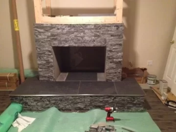

Hello,
I'm new to the pellet heat side of things. Moving away from geo thermal as hydro costs are killing me (and in my opinion sucks)
I bought an Enviro M55 Insert. In the manual and on the unit it shows I can exhaust vertical or horizontal to vertical with this insert. My question is can I just go vertical from the insert without a "T" or should I go through the wall and then vertical with the "T". Yes I am going through my roof both ways. Is one way better than the other?
Thanks
