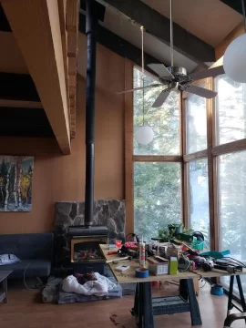

I am replacing my propane freestanding stove that was once a wood stove to a Castle Serenity pellet stove. My ceiling height is about 14 feet. 140 inches of that is 6 inch pipe, the last 2 feet are 8 or 9 inch pipe. Where should I tie in my 4 inch pellet pipe? i would reduce costs by tying in about 60 inches up, or should I go the full 140 inches to the bigger 8 or 9 inch pipe?
The 8 or 9 inch pipe continues 2 feet to the roof then through the vent and an additional 5 feet or so through a chase then into the air.
![Pellet Venting Questions Pellet Venting Questions](https://www.hearth.com/talk/data/attachments/237/237503-cc2fcf621c5a635db3e29bfb92b57d87.jpg)
