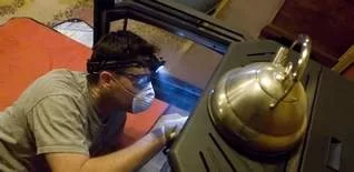

If you look at the picture, the door has a 3 piece glass, and the top has air slots in the part in front of the hopper. That should be enough to ID the stove. Napolean maybe? They got pellets for well under $5.00/bag, and the reported usage at highest heat/blower setting on a -15F night doesn't seem all that outrageous, if the hopper holds a 40lb bag, of what brand we aren't told, and being new to the stove, they don't have much experience with fine-tuning the settings to the pellets. Our Englander 25-PDVC's hopper holds just under a 40lb bag. My computer won't bring up the comments at the bottom though, so I don't know what the fuss is about here?.

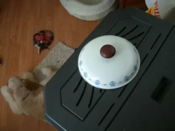

Well, after Glancing at the pic, not that it makes a Hill of Beans difference, i'd have to say Bares a close resemblence to my stove, Enviro EF3 Bay, or Possibly the Smaller EF2, going by the Grates in the top, mine are slightly arched, can,t tell past the tea Kettle, which we don,t own since no one here drinks Tea.The Pot Cover was to try and Replicate the covered space so i could compare better.If it is indeed a Enviro EF3, it has a 50 Lb Hopper, as does the EF2 i believe,also has a Huge Ash Pan which needs dumped every month.Attatched is a simmilar shot of my stove ,just for comparrison sake...

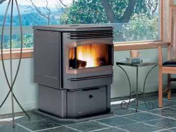

Added pic of Meridian,Lets try that once more, not a very good top shot but looks like the Enviro Meridian has no removable Grate, tis Prob this model,anyone else got better shots of Meridian top? also has 55lb hopper.

Nope, Guess i was wrong there, simmilar, but not the same, never seen a EF2 so not sure if it has the removable top panel like the EF3 or not, oh well, was just a guess, lol...<<<Goes back to Reading Posts and minding his own buisness

Yes that is a Meridian in the photo
The meridian holds about bag and quarter to bag and a half of pellets depending
