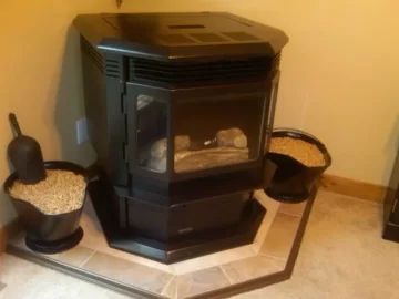

I am with J-Takeman so Do NOT give up on heating the house with a wood pellet stove in the basement. All installs are different and some people cannot heat the upstairs from the basement, but believe me I can and many others here in the forum are doing this also!!
I built a hearth near the homes original chimney and vented my pellet stove into the chimney because it is right near the door to the upstairs and the 80 degree heat will rise right up there! Then I installed a double wall stainless steel chimney for our furnace!
This worked really well, our bedrooms do get heat because it rises up the stairwell since I keep the door to the basement open. I could put another duct in the master and end bedroom but we are happy with those rooms a little cooler meaning 68 degrees when the living rooom and kitchen are 72 degrees F.
With the basement install I have 1.5 tons delivered to the basement right near the stove and another 1.5 tons in the garage next to the basement under the house.
This means I only have to carry the 40lb bags a few steps and dump them into the hopper. Sometimes I do spill a few pellets but it is in the basement and can be swept up easily. Also when cleaning the stove, any mess is in the basement and can be cleaned up and is out of reach of the children as well.
