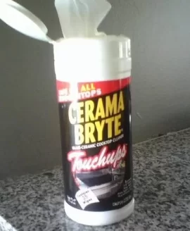

I like these got 'em last year and work good for a quick cleaning. Ie: I don't worry about spaying something
on hot glass and cracking it.
For heavy cleaning I use the liquid when I do the shutdown cleaning..

Those Wipes were like 3 bucks and the wife uses them on the cook top too...
Wow good price. Darn things are eight bucks here.
