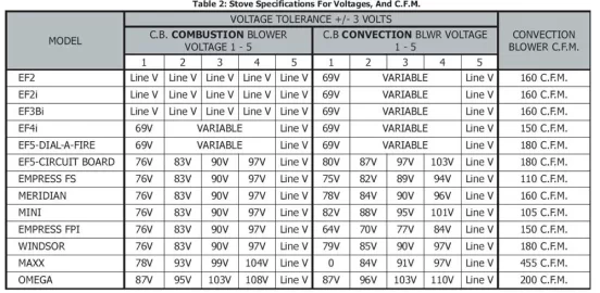

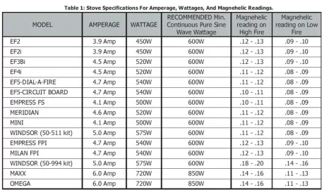

This might help
here is some detailed voltage and amp charges for enviro
