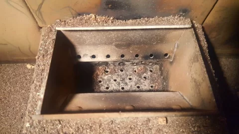

It is a ph50cab,not a cab50.Completely different burn pots.If your install is good,with your mods,and you have to clean the pot after 3-5 bags,should be ok.If it goes longer than that,you are probably wasting heat up the stack.
In that old style of stove,you are supposed to have buildup in the pot,if you do not,lots of heat is going up the exhaust.
Burning pellets leaves clumps,from impurities.In an old style,if you are not having clumps form,then the combustion air is so powerful,it is blowing the crap out,which means more heat is being blown out the exhaust(too fast) that could be used by the stove.Other stoves have a shaker grate system,or sliding grate system,or a self dumping pot,or they are a pusher stove--bottom feed-as a harman,which self cleans.

I still have too much air but this is how the burn pot looks after two days without cleaning.
this also stopped the rumbling noise related to the draft that my stove was making.
