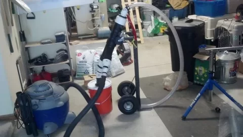

I was looking for something that would transfer and clean my wood pellets. Almost a month after paying for a cornvac I still hadn't received it nor a reply to my emails inquiries to the company.

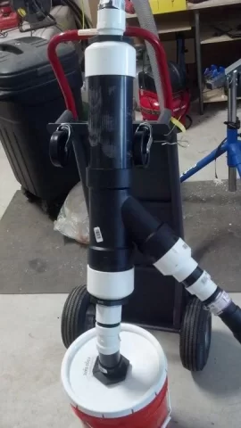

I ended up building my own. I had been to HD so many times and spent so much money that an associate gave me a 10% discount "for my tenacity" as he put it.
After 2 exhausting days of trial and error and more than a 12 pack (I was very close to consulting Johnny Walker) I got it to pick up my test bucket of pellets mixed with fines separate the fines and transfer the pellets to another sealed bucket. Not even 2 minutes later I get an email from Cornvac apologizing for their computer malfunctions and asking me if I still want their transfer device.
Theirs cost $65. I spent close to $200 in screw ups and liquid therapy(Beer). Should I keep mine or realize my victory, break it all down, get roughly $100 back in HD returns and go with the Cornvac? My wife says take the stuff back. My caveman instincts tell me to beat my chest and keep my kill. Either way I still have to clean the garage.

I did see the ones in the forum but they only accomplished half of what I wanted. Mine works really well now. Upside down and backwards on purpose. There's a 1/4" in screen tube inside the 4" that allows me to suck in pellets without varying the vacuum via air holes. The fines are separated and sucked out while the pellets move through the inner tube to the destination bucket. I can clean and transfer pellets in excess of 50ft now without having to lift a bag. I just open the bag where it sits and suck out the pellets. Got it from John Abbot of iburncorn.com. It just cost a lot of time and money to make. I tried to make a horizontal version and realized that gravity was my friend so went with 22 deg elbow instead.

Nice, I like your system much better than the other hand made ones! Instead of transferring them into another bucket can you blow them right into the stove hopper? That would be the BEST!
I haven't seen good results for blowing directly into the hopper because the terminal end has to be sealed. That may be my next brainstorm. It was really easy to clean out the hopper and auger of the remaining pellets I didn't burn. 30 seconds to remove approx 20lbs.
