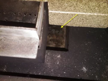

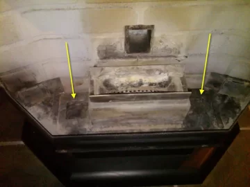

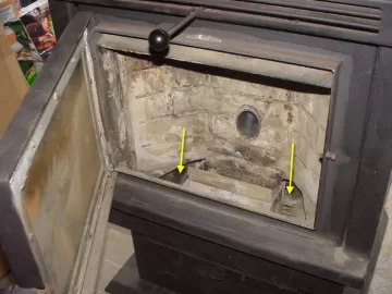

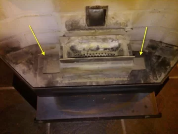

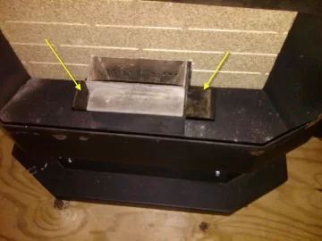

There is no magic in getting more time between cleanings it really depends upon how your stove is built.
Travis who makes Avalon and Lopi like the whitefield design closes off the Ash Pan to the fire chamber when burning supposedly to give a better burn. Only when the stove is off and the door is open, then you can open the ash dumps and sweep the ashes into the ash pan.
See the 1st 2 pics below
Other stoves are more open to the ash pan so ashes can fall in there while burning.
The Pelpro has 2 open squares right next to the burn pot so sme of the ashes can fall directly into the ash pan while burning
See 3rd and 4th pics
Enviro has an almost suspended burn pot similar to Magnum so more ashes can fall directly into the ash pan while burning
A good gasket seal on the ash pan is needed to get a decent burn on these stoves. See last pic below
