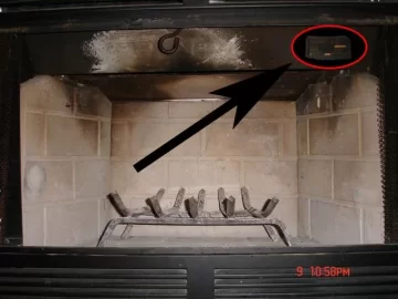

If you look at the front of your fireplace, there should be a metal plate that has your make and model. You can then do a search on the net to find the technical documentation. That should give you a good idea of the dimensions inside your pre-fab. If yours is small like mine, you will be very limited as to what you can fit into it.
I attached a picture that shows where the model plate was on mine. It's on the upper right of the picture.

Thanks, I'm sure my fireplace is one of the smaller ones. I do see a sticker on the left side. It seems to be made by Superior. The model number is a little harder to read. Will need to do some research on that to see if I can figure it out.
