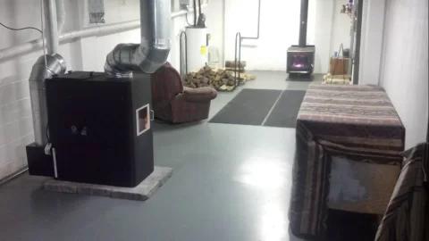

I live in a Ranch home w/ full basement. Upstairs is 2,180 sq and downstairs is 2,180 sq. Although the basement is pretty much unheated, except the portion you see in pic (little more behind where I am standing) which is about 800 sq.
So its about 3,000 total heated. Up till this season, I had just the Quadrafire Classic Bay 1200 upstairs. So the furnace and my woodstove are in there 1st year of use. I mainly use the Fahrenheit to heat the house. If its about 35° or up, I use the Quad. I have used the furnace without the wood stove, but 90% of the time, I have it Crankin in the basement. I can get it scorching downstairs, so the Fahrenheits efficiency is boosted by the hot air from the woodstove.
The furnace is never on anything higher than level 3 (on a stat) and most times. It stays on level 1 (pilot/maintenance burn). Its always generating heat. So it heats up to my set point of 175°, then kicks on (10 min) till it cools to the next set point 110°… The fan is always kicking on and off. So even when the stat is satisfied, you are getting some heat. Which causes the house to not lose heat as fast. Which means the stat will stay satisfied longer.
The furnace has a self cleaning pot. On premium pellet setting, it auto cleans every 9 hrs. So you start fresh. Only downside to that, is the furnace ramps up to level 5 for about 30 (entire process). So if the temp is already 73°, then its gonna jump a few more. In my case about 3°-4°…
I love the furnace. Im only using half of the ducts in my house. Split up in 2 main trunks, that all registers feed off of. I feed into just one. It feeds the bathrooms (2), bedrooms (3), and kitchen (2). Our master bedroom is fed through the register in our bathroom. So all rooms get have a register, except the Family room (but its basically the same room as kitchen), Dining room (Quadrafire pellet stove room), and Living room.
If I had to buy new (mine was used 1 season by previous owner), I would look really hard at the St. Croix Revolution. Its 70,000 BTU's, but has a cleaning system that I think is superior (I think, never operated one. But it reads better and doesn't need Level 5 blasting to do it). The Harman PF-100 is the Cadillac of Forced air pellet furnaces. So its a good candidate also.
But I do use wood to supplement. It has saved me quite a few pellets already. I used about 4.5 ton last year with just my Quadrafire (4 tons in prior yrs). This yr I have used about 70 bags to date. I may stay around the 2 ton mark. Granted it has been a warm Winter. But the 2 cord of wood I have burned has probably saved me almost a ton of pellets. Above 45° I can get by with just wood heat and Zero pellets.
