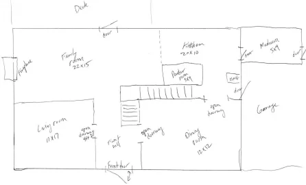

Attached is a rough schematic of the 1st floor of the house for curiosity's sake. Master bedroom is directly above the family room on the 2nd floor, with the bed located almost directly above the hearth. The two guest bedrooms are at the opposite end of the 2nd floor but we are not concerned with heating them as we have no children and I can throw a space heater in whichever room we have visitors stay in.
