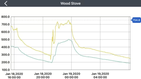

Hi, I have switched from a HT2000 to a PE summit this year. I have thermocouples for STT and Flue temps. I’m curious if anyone has any data for a summit. I’ve searched and found some old threads. My old stove when settled in the STT were always 100F+ above stack. With the summit my flue temps are always higher. It heats fine. Just doesn’t seem to come down on the flue temps. Looking for any thoughts. Stove is brand new this season. I can hear EBT moving. Door is tight. No ash pan. Currently 750 stack/650 STT
Yellow is stack/blue stt
Stt is actually about 100-150F higher in the hottest position usually
