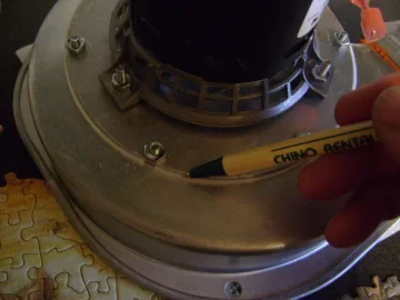

In a pinch you could use some high heat (red) RTV along with the old gasket. Don't use it on the gasket face or you may have trouble removing the motor at a later date. Once you reinstall the motor with the old gasket, run a bead of RTV along the outer edge just where the gasket sticks out,to seal it up (see picture). You can even fire the stove back up while the sealant is still wet and it will cure just fine. High temp RTV can be found at any auto parts store or hardware store. Good luck.

Ok I have the fan out, gasket DOA. Have RTV and 3 in 1 oil. Still trying to figure out exactly where to oil this. Most of my time was spent digging through my husbands mess of tools, can't find a freaking thing.
