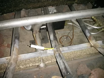

Greetings - first post, looking for some assistance. I have an LP insert in the fireplace that was here when we bought the house a few years ago. The seller stated that she had never run the fireplace.
Just had the tank filled and when they were checking the system out, discovered that it is missing the pilot assembly, at least. The tech was unable to assist beyond that, they don't do inside work.

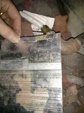

According to the tag this is a Vermont Castings unit, but I can't find the specific model number. The label says it was originally a Model 000-5133 Natural Gas Heater, with a label that indicates it was changed to a Model 000-5176 Propane Gas Heater. The (non-original) manual that we received indicates a model 3380/3381 Radiance vent-free heater, although all that is installed is the burner assembly, not the whole unit.
I contacted a local VC dealer and sent these pictures, their reply was that it is an older private label unit, and that parts are not available, so I should come in and look at new inserts.

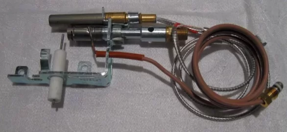

I think all I need is the Oxygenerator 8404, part number 55465.
Can anyone confirm or deny this, based on the pictures and info here?
![Parts for older VC Insert Parts for older VC Insert](https://www.hearth.com/talk/data/attachments/122/122038-9e3f1a63caffd695013f40df65a549ed.jpg)
![Parts for older VC Insert Parts for older VC Insert](https://www.hearth.com/talk/data/attachments/122/122040-b3c18bebf88a756f8b1f8f80b37f7cb0.jpg)
![Parts for older VC Insert Parts for older VC Insert](https://www.hearth.com/talk/data/attachments/122/122039-74991a70abbf34b9c8305fe622f92cea.jpg)
