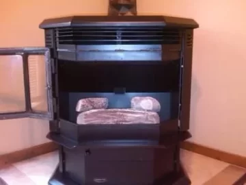

I put the leafblower on my Quad last year (and will do again this year) and my Fahrenheit furnace this year also. I hook up the leafblower and paint the inside of the firebox. All fumes are pulled through the vent and house stays fresh and clean.... Only takes a minute and looks good [Hearth.com] Pam Cooking Spray Question [Hearth.com] Pam Cooking Spray Question [Hearth.com] Pam Cooking Spray Question
  • [Hearth.com] Pam Cooking Spray Question

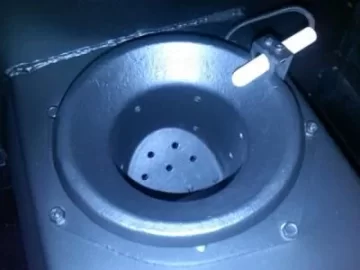

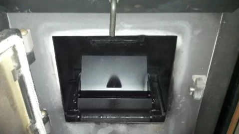

I use VHT Flame proof 2,000 Degree F Header Paint for car exhaust headers from Pep Boys Auto Parts on the inside of the firebox!
This Paint is Flame Proof and will NOT burn off. They use it on JET Engines!! See pic Below:
