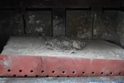

1st year burner....Insert (PE Vista) was installed on 12-7-10 and I burnt pretty much 24-7. As much as I could anyway for it being so small. Well, season is over for me and this weekend I took out the baffle to look up the liner. The baffle itself is rusty already. Is this normal? Not flaky rust but definetly rust red in color. It never went above 650. There was also some hard grey material sitting on top o f the baffle. It looked to be a type of cement or something. Is this just the excess from the installer sealing the connection to the liner?
The unit itself performed flawlessly. Any PE owners care to chime in on what their baffle looked like after year 1?

My guess is that what you are seeing is more oxidation than rust. After the first 750°stove top fire I had my baffle got the same reddish color that you are talking about and I'm not real concerned considering it's being subjected to 1200°+ temps. I'm sure someone with more PE experience than me will be along to explain what is going on. How have you liked your insert so far?
It is the oxidation of the iron and is completely normal. As Certified stated, the baffle experiences high temperatures. Stainless steel oxidizes under high temps. My baffle also experiences extreme temperatures and sometimes will even glow a bit. After the first burn season, it looked rusty too.
Sagging/deformation of the bottom middle of the baffle also happens. They are warrantied for life, so nothing to worry about.
There should be a metal plate sandwiching a ceramic blanket on top of the baffle. The grey material on top of that could be any of the hard-pan minerals/ash left over from the burn. If you can, take some pictures.

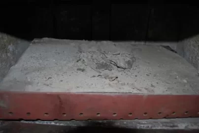

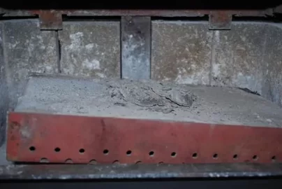

pics attached. The powder was ash, like you stated, the hard big chunks had little spiral lines on it, definetly from the liner at some point.

I don't think you have anything to worry about, not sure what the other crap is but the baffle is the same reddish color as mine.
It looks good and absolutely normal to me. I get whitish-grey deposits on top of the baffle and around the secondary burn outlets. They seem a bit harder vs regular ashes. My theory is that they are other minerals that are part of the wood chemical composition and are left over from the secondary burns of the gases and particulates.

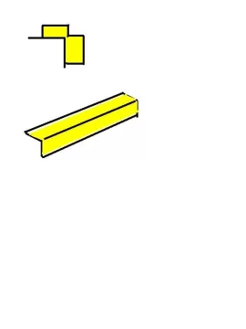

Hi all. I have recently replaced the mild steel rails and baffle in my super 27 with the SS kit. After searching here (thanks for the tips on the baffle gasket) I can't find the proper orientation for the insulation pieces that go behind the rails. Do they sit in on top of the rails vertically, or do they curve around to touch the baffle sides? I have them in vertically now.
I don't have a Vista, but if it is like the larger stoves I think it sits vertically, on top of the rail.
The rail insulation sits between the side of the baffle and spans across to touch the side of the firebox. It should touch both, closing off the area between the two.
So the insulation should be horizontal, not vertical? Then there is no insulation behind the rails on the sides above the bricks, correct?
Sorry fo all the questions, but this is a new configuration for my stove.

The insulation should have a split along the length, allowing it to conform with the 90 degree bend in the rail. I did a poor rendition of how it should look, with the yellow being the insulation.

Thanks, I will check that out when I get home!
