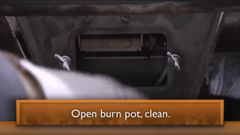

Codes 5&6 do not need unplugged to reset,just turn stove mode off then back on.Having a new cradle in hand will not tell you which way it goes into stove.
  • P68 igniting issues
Reactions: Mt Bob
Thanks bob! i believe the fins were pointed out so I'm guessing the bracket got taken apart and installed incorrectly. Hopefully the issue is that easy to fix. Will post an update when i can make it to the UP and take it apart. Thanks for the suggestions
Yep might be the problem.If interested,the ignitor place on ebay has the aftermarket 310 watt ignitors on sale for 28 bucks,delivered,might get a spare.
