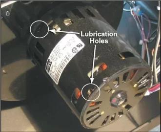

Have you tried lubricating the motor? Many of the motors for the distribution (convection) blower have oiling ports that may solve your problem.
How old is the stove? Have the motors been checked/serviced ever?
If if it looks like the pic I supplied below, you can see where 2-3 drops of light 20w non-detergent oil (3 in 1 oil will do) can be put....it might solve the problem.
BTW, sometimes these oiling ports are on the underside of the motor....the motor/blower may have to be removed from the stove to lube it properly in that case.

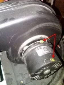

To my knowledge, there is no way to oil the distribution blower on a P68. If the blower has failed, the labor is covered by the warranty. Are you saying he will charge at least $150 to just come out to see what the problem is? My dealer never charged me for anything covered under warranty, and your blower is still covered. I suppose if you're really far away from him that would justify an extra charge, but it doesn't seem right if he's close by. I would call and double check before you try to do anything yourself.
We purchased the stove new in Oct. 2008. We have never had it serviced, only minor things have went wrong that we were able to take care of. The dealer is only a 20 minute drive from us and he told us when we bought it that regardless of warranty, he charges 150.00 for having to come out to fix something under warranty which really stinks. So you think there is no way to lube the P68 then?
That really stinks. I wouldn't be buying any more stoves from him, although at least he told you up front. I am pretty certain there is no oil ports on that part, but maybe someone who works on them could chime in. You may want to post this in a couple days, we're having storms and I think many people are distracted and/or out of power.

Some blowers do not have oil plugs and cannot be serviced. If this is the case, then you need to just replace it!
