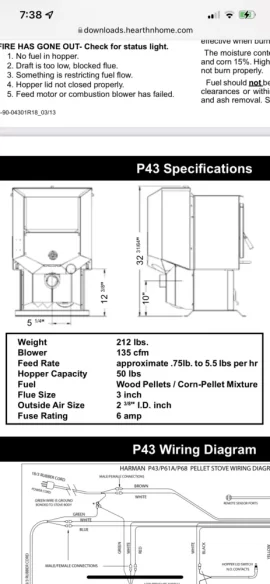

Min spec is .75/hr…fact. That’s what the factory says it ls not me…I do t believe it but that’s what it says. How I can set it to that is question…I don’t see it happening but it would be great if I actually couldThe specs I see show burn time on low as up to 37 hours, with a full hopper,which is 50 lbs. Now that was probably done under ideal conditions, with optimum fuel. That would be 1.35lbs per hour. Also,your feed setting may be hurting you. It is for "max" feed, and running it that low may keep telling the probe it is too cool, actually increasing your usage.
it will never happen. they are lying. I have the P-43. on that lowest setting it will use a bag a day. last maybe 22-23 hrs. I laugh when I see people say I got a P-68 keep 2000 sq ft house at 70 using one bag a day. never happenMin spec is .75/hr…fact. That’s what the factory says it ls not me…I do t believe it but that’s what it says. How I can set it to that is question…I don’t see it happening but it would be great if I actually could
I would too...I laugh when I see people say I got a P-68 keep 2000 sq ft house at 70 using one bag a day. never happen
So to end this, after running different settings and running some numbers the min feed rate of my 2012ish p43 is approximately 1.6 lb/hr
