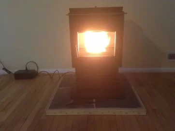

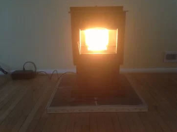

Here's my pic. Not much to show, just got it running. It's hooked up to APC battery backup/ surge protector. Made the hearth myself.

Thanks for all the help...I've had a lot of questions :)
That's great ! Is it making heat for you yet ?
Yes! It's 27F outside, snowing. its 76F on the floor where the stove is, oil furnace resting :)
Amen brother, that's what it's all about !!!!!!!!
