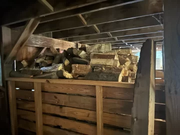

How much? Already CSS'd? (cut, split, stacked)
Rough measurements put us at about 2 cords.
