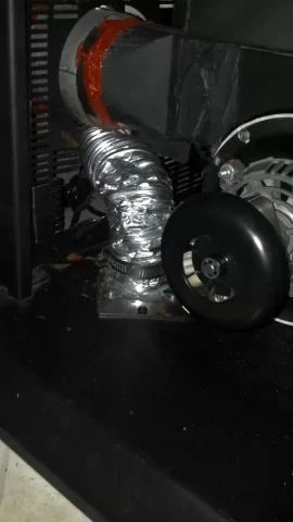

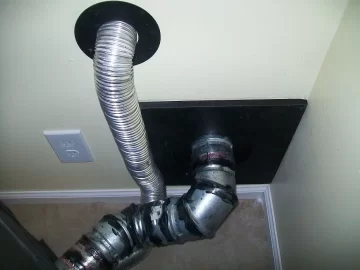

Here is my stove setup, home made, a tube soldered to a plate. Outside plate with screen and tube and rain shield.

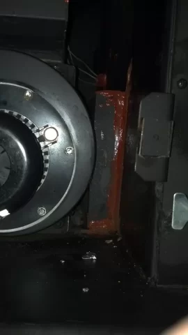

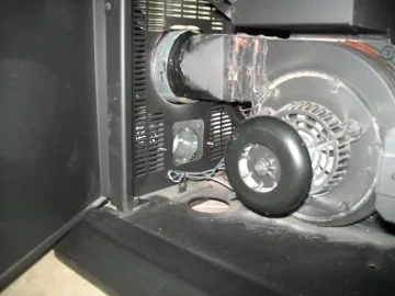

Here thet are..
I dont know slls got his pipe through that small hole. I remember like it was yesterday... I was cursing and throwing $hit everywhere. That hose was NOT coming through that square opening that you snip the corners on.. If you look in the last pic. you can clearly see where I took a Saw-zal and made the hole big enough. By that time I had screwed up so much of the pipe, that I couldnt cut off anymore and had to use the "Ugly" section that I last tried to SHOVE through the hole before cutting with Saw-zal..

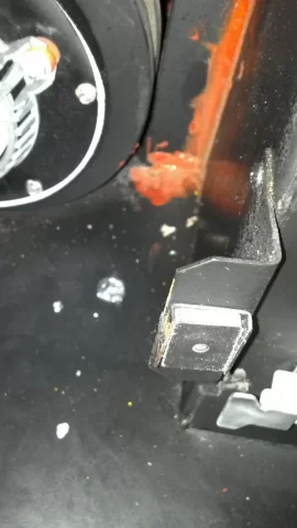

Anyways, you can see in the other photos the high temp red silicone. Its on the channel that goes up the back inside firewall of the stove, you can see where the ash pan latch is on the right side of the photo and the combustion blower on the left side of the photo.. Kinda hard to get in there. Could use my hands for the sides (High temp silicione on finger and spread).. Although its not pretty, it works much better at pulling "Just" outside air.
I also sealed the Metal fitting that the pipe slips over (I call it a "Neck") It had holes and gaps in it. Along with taking aluminum foil and filling all the holes on the floor of stove (You can see some in the photos, small peices that fill the shipping bolt holes along with a bunch of other small ones) I could have used high temo silicone, but these seal well and are removable without ever knowing they were there.
Hope this better helps with the understanding. The instructions are pretty straight forward. If you need more help, just ask. Kit comes with a lot of extra parts (Also goes to Santa Fe, Castile, Insert models also)

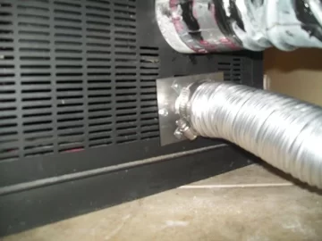

I got the stove all installed...I do have a question regarding the outside air kit though. I know from the following pics you both provided it goes through back of stove and into the bottom of the right inside of stove. From the pics I provided when my father in law helped install it when I had to work, he put the collar assembly right into the back underneath the stove pipe and then clamped the house into it there. Only problem now is that I don't know if there is enough of the flex hose to place it to where the diagram shows to put it inside of the stove from the way it is now going through outside wall. Every other pellet stove from quadra fire shows to put it where he did except for the classic bay 1200 freestanding which I have. If I can't get it down to where it is suppose to go, would it be ok to keep it there as long as its sealed like crazy all around it? This morning the flex hose had condensation on it. Is this also normal? Please help. Thanks.
  • Outside Air Kit for Quadra Fire CB 1200 Question?

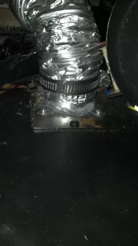

Not sure how effected it will be the way you have it. When I had mine it wad attached to the base with a home made collar. You might be able to find a 2 inch 90 degree somewhere. You won't be able to really tell unless it's attached to the base.
The mounting plate is not to go on the back plate of the stove. It should mount to the floor of the stove. Where the hole in the floor of the stove is. Is where the plate goes. Then the hose goes through the square hole and connects to it.
He hooked the mounting bracket to the wrong location. Needs to be corrected.
Yeah, I wasn't home when he installed it. I left the directions and thought he'd follow them, but I'm not sure if he looked at the cb 1200 insert and the rest and saw it like that. I am really hoping I can fix it. That kit was expensive. I don't know if I can stretch that flex cable anymore though. What do you think?

There are really cheap OAK kits online. Some as cheap as $20. I have thought about purchasing one to replace my kinked hose. But it only looks bad inside the stove. On the back of the stovr it still looks fine.
You should be able to remove the mohnting plate off the back of the stove and put it in the proper place (on the base/floor of unit) and try to get the hose to reach.
And Yes to the condensate on the OAK. It will do that and may even frost over in colder weather. Some people have insulated theres. I have just tried to seal my system as well as possible. The route in which the air travels on a Classic Bay, is a long one and the air is preheated plenty before reaching the burn pot. And if you dont seal it, the air is mixed with inside air and preheated. So either way it should be fine. If it starts dripping and forming puddles, then I would worry.
The hose can be had pretty cheap. Or try the auto parts store and get some flex pipe there.

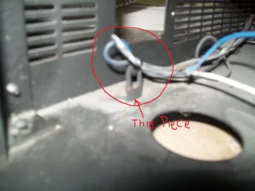

I need help. I am trying to get the collar assembly to fit to the floor of the stove and there is a metal loop that is holding the wires that go to the blower in place. It a solid metal piece. I placed a pic of it below. Should I cut this? Cause it's blocking me from being able to fit the piece right so I can screw in the holes marked for it. Need help quick. Please reply. Thanks.
I didn't cut mine, Trim the collar if need be.
I think the OEM collar fits diagonally.
I trimmed the collar also. Or you could grind the tab. But you can take the collar outside and leave the grinding out of your living room. Either way. One has to be cut/trimmed.
What did you use to grind the collar down with. I really don't have much for tools yet...lol. For the price this kit costs, I'm surprised they didn't make it fit better. This is crazy!
I have several grinders. I used my DeWalt cordless grinder. But a Hacksaw on either the tab or the collar will work.
Ok, It is cut and fits now. I need to now figure a good way to get the wires out of the way. I'm afraid any of the condensation from the flex pipe could do something around the wiring. I don't want any electrical getting wet and catching fire. Can this happen or am I good? Also my flex pipe I'm having trouble getting to go around the collar on the inside now. Plus the flex pipe is right up against the main venting from the stove going outside. Can that hot venting melt that flex hose?
