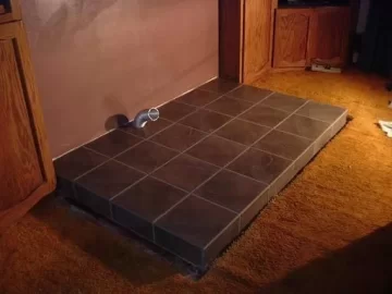

This is the first year that I have used a OAK. I did not want to drill a hole thru the floor or side of the house. What I did was made a board with a 3" hole in that just fits into a window. The board is insulated and the window shuts down on it. So far it has been working great and I can remove it in the Spring. The other nice thing is I don't have to worry about being around the stove as much with oxygen as it is getting it's air from outside.
Don
