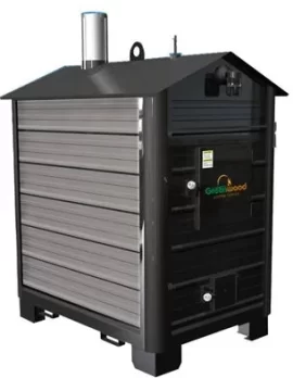

Beginning in 2007, some new OWBs were introduced with advanced combustion designs that pass a new voluntary EPA (Orange Tag) standard for outdoor units. If they perform as well in the field as they have in the testing labs, these new boilers will provide many benefits over the older technology, including more heat for less wood and less smoke and pollutants. In addition, the newer EPA-compliant units are likely to be exempt from the state and local bans currently being implemented.
Yukon Multi-Fuel and Add-on Furnaces - Burn wood/coal and oil/gas efficiently in one indoor furnace! Automatically switches between the fuels. For over 40 years, we’ve been the leader in UL approved multi-fuel hot air heaters. Multiple sizes as well as wood-only add-ons.
Greenwood Aspen EPA Approved OWB
Note that there are also some “hybrid” gasification boilers entering the market now (2008) which are basically indoor boilers housed in a shed and adapted for outdoor use. These are typically pressurized units which have smaller (5-10 cubic foot) fireboxes than traditional OWBs.
