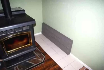

Well last weekend we picked up a lovely Whitfield Advantage 2T and got it all cleaned up Sunday and working sweet.
Now its time to get going on the install.
Not as easy as 1,2,3.

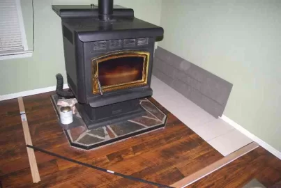

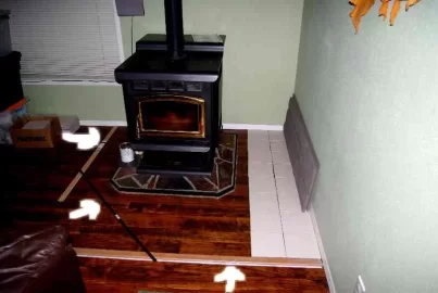

The Whitfield has a low exhaust stack that even on a hearth pad will intersect right though the middle of wiring in the wall...

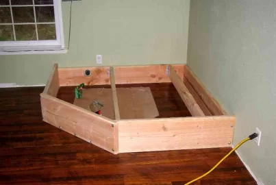

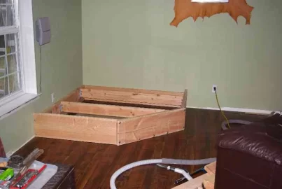

OOOOOOOOOK so the plan is to build a Raised Hearth a total of 10-5/8 inches tall with ceramic tile on top of it.

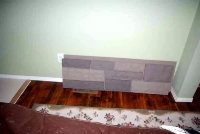

Going to do a rock look treatment on the corner walls using the 4 foot long interlocking panels..
Finding resonable prices on anything is tough.
This morning I found a Habitat for Humanity store that had 8x8 tiles just the right color for 25 cents each YESSSSSSSSSSSSSSSSS
Have Craigs list ads running to see if I can scare up some good used pellet pipe and other goodies to finish the install..
I am a scrounge by nature and love to wrangle a deal on used things.
I will be taking pics as the install proceeds and will post them here for all to see.
The corner currently has the WP50 Earth Stove sitting in it.
Will be sweet to have this all done.
The stove thats going in is the one in my avitar
