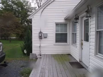

After reading the forum I have decided that the only option I have is a Corner install through the wall. I will also be exiting on the Front of the house. I am leaning towards the up and out method. So I am thinking Clean out Tee on the bottom, and then 3 ft vertical, 45 degree ....Then 1 ft to wall thimble? I have been trying to find a black vent pipe kit also... any help would be appreciated.

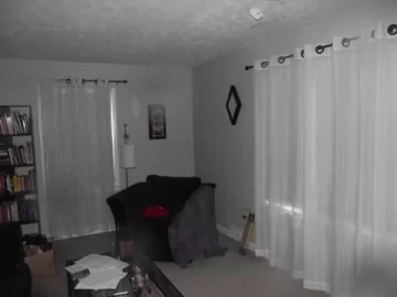

Ok the Stove would go where the chair is about where the mirror is, and then out of the front. I would remove the bush.Also the peeling ceiling is from recent Storm damage.
