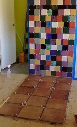

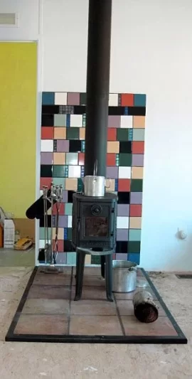

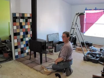

Because this went in a little POS double wide which is temporary, we agreed to construct the hearth as cheaply as possible. Making sure to line up the stove vent with the existing ceiling box, we screwed 2 sheets of 5/8" Durock to the floor, with a layer of thinset in between. We then laid 13"x13" ceramic tiles from The ReStore on top of this, and grouted with epoxy grout. (Epoxy grout is very difficult for the non-muscle bound to work with. Just FYI-) The floor trim is routed 2x2s, ripped beforehand to be the same height as the floor hearth sandwich. I painted it with the same black heat resistant paint I'll use for stove body touch up in the future. (Two birds, one paint can.)
The wall shield, which we realize now was overkill for the stove given its 18" distance from the wall, is one piece of 5/8" Durock with metal spacers, screwed into 1"x2"s that were screwed into the studs. That was then covered with a mix of 4" wall tile from the local ReStore and opalized glass tile leftover from a bathroom floor. We joke that it looks OK, except the wall tile "is so dated". The fella helping us at The Restore was a tile setter, and he gave us his opinion as we searched for various colors. If he only knew where this was installed! The mice lived well before we got there and evicted them.

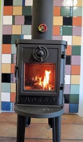

Thanks Jeeper and Frogwood! (Gotta love these user names.) It has certainly added a needed dose of color and whimsy to the room. It has been 15 years since I lived with a wood stove. It is difficult to compare the little Irish stove stuck in the corner of a 120 year old, uninsulated Victorian, 15' x 32' living room in the UP of Michigan to a stove almost in the middle of kitchen/living room in a 2002 manufactured home in Cañon City, CO (the banana belt). But we are extremely pleased with the stove's performance. Within 15 minutes, the whole room is shirt sleeve toasty. It has a relatively small firebox that runs N-S, but it will take an 18" split. We've have been using dead fall branches from the cottonwoods in the wash exclusively, since they were the low fruit. It is not capable of holding through the night, but we never counted on that anyway. Only the dogs complain that it isn't as warm when they wake up and it is when they go to sleep.
The attached pic shows the size of the firebox more clearly.

One of the best things about this little stove is how quick it heats up. We start the fire in the morning, and the eggs are cooked on it in 15 minutes. We've heated chili and corn soup on it with wonderful results. We use a lot of deadfall, including small branches and twigs that others leave behind because it takes too many to fill the firebox. The only problem is that now I want a bigger living room/kitchen and a real cook stove. Next purchases - another chainsaw and a splitter!
