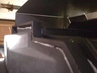

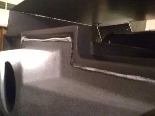

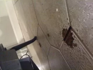

Well tonight, I happened to look over to the hearth and noticed 2 creosote puddles (presume to be creosote, it is liquid and it is brown and it smells like structure fire smells like - dirty smoke) under the stove. I am trying to get pictures uploaded but in the meantime - I was able to see where the creosote is coming from. It isn't the chimney connector and it isn't the air intake hole at the bottom. All along the outside of the stove where the stove appears to be seamed there is some white cement like material. In a couple spots (right above the leaks) that white cement area is brown, suggesting to me that something is leaking past there somehow...
Don't see anything about this on the forum so I don't know what is going on here. The stove hasn't gone above the 670 or so (as measured on the stove top front left corner, as Jotul suggests) that we reached last night. No deformities/cracks anywhere except that little leakage at those seams.
Will get pictures once the iPhone is done sending them and I am done resizing...
