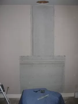

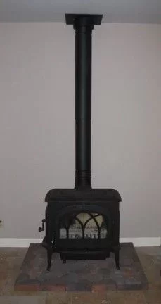

Finally got around to installing my new Jotul Oslo.
Also added 10' of double wall class A chimney in order to get about 16' total for good draft.

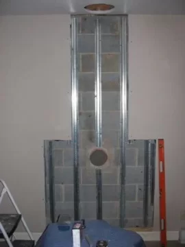

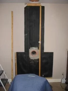

Due to the truss layout I had to put the support box closer to the wall which only gave me 5" to the pipe from the wall.

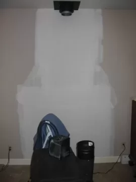

Given that my house is block, I could have just pulled out the drywall and painted the block. But I decided to pull off the drywall and re-frame with metal and cover with 1/2" durock. Skimmed out and painted to match existing wall.
I have attached photos of the process so far.
One more trip to Lowes to get a few more brick pavers to finish out the hearth in order to get the required protection.
I'll post photos of the new chase I had to build if anyone is interested.

The new chimney is working very well.
If I had this set up with the Nordic I believe I would have had much better performance,and less smoke, but still not enough heat for the whole house. There is absolutely no smoke when I open the door now.
This stove is one powerful heater! I can actually heat my whole drafty house with this thing. It's great!
Tonight will be the first real test since the temps are supposed to be down into the mid to low twenties.
Although, I am a convert to the interior chimney. I am not a big fan of the whole exposed stove pipe thing, but the straight shot up the roof, and good draft is worth it.
Thanks to Hearth.com, and all the folks, for providing a venue to share the advice, good and bad, about wood burning.
J.P.
Corie said:
Eh, not to burst any bubbles, but the paint you put over the durock is flammable, is it not?
I looked into it but the only answer I could get was that it does not increase or decrease flame spread.
Flash point is rated at 230 degrees celsius
J.P.
It's hard to tell from the picture but the stove seems to have a generous back clearance. If yes, this should be a non-issue.
What is the distance from the rear of the stove to the wall? Does the stove have the rear heatshield?
Sorry, that's too close, no matter what the wall is made of. The minimum without rear heatshield is 12" to a protected surface, 18" to an unprotected surface. Follow the manual's clearances. Increase the space or add a rear heatshield and move the stove out an inch.
