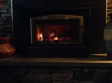

I never really see flames up near the tubes, but I haven't had a chance to really pack it full. Daytime temps are 50 and nighttime is in the 30's. [Hearth.com] Osburn 2400 insert installed this is with the air all the way closed!

I never really see flames up near the tubes, but I haven't had a chance to really pack it full. Daytime temps are 50 and nighttime is in the 30's. View attachment 115631 this is with the air all the way closed!
This seems like a very small load. If I burn like this, I definitely have smoke coming out of my chimney. Usually I like to burn at least three splits at a time to allow for a clean hot burn. What's the stove top temp in this picture? Unless of course this is the end of a burn cycle and most of the wood has burned down.
About 300 degrees. What is the best stovetop temp to run at?
