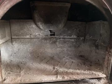

Hello friends. This is my first post on the forum so excuse any ignorance on rules.
I have just purchased an old 1930's WPA house in upstate New York, which has a new addition from the 80s. In the addition, there is a long great room that wraps around the old house in an "L" shape. In the bottom of that L, the shorter side, is this old Jotul 8 wood stove. The external wall of the L is drywall. The interior wall of the L is the old house's exterior wall, which is flagstone. Ceiling is wood beams. Flooring is wood. Stove is against the interior wall halfway through the bottom of the L.
I've had the chimney/flue properly set up in the first few weeks of owning the home, but the stove itself seems to be in bad shape. The stove is close to the stairs to the upper floor. The entire house is 3000 sqft. The downstairs is probably 60% of that, but we have a big stone wall that the stove isnt going to heat through (the only door through is on the other side of the first floor). I'd say the stove is in an open space where it can heat about 1000sqft on the first floor, and then the upper floor which is about another 1000 sqft. We have a rinnai propane wall heater in the same room, so we're not going to freeze to death this winter. Currently we are chewing through propane quite quickly due to the old house being poorly insulated. If we heat the great room up to around 65F at 11pm, it will stay at around 56F overnight at 9am. The old house is hard to heat past 50F. We're gonna be doing a lot of insulating work once the winter ends, but for now this is our situation.
I went ahead and tried to run it around 500-600F (off a reading on the stove front) yesterday, and it kept reasonable heat for maybe 4 hours, but then petered out. This is the old jotul 8, which only has the lower door air control, and even fully closed, the air flow is very hard to control. I would assume the huge hole in the back is not helping.
I've priced out the right side and back replacement parts, about $200 w/o shipping or install if it's something a tech should do, but I've seen a number of posts on this forum that the jotul 8 is not really worth it to repair, as an upgrade will operate for longer and more efficiently.
So the questions:
1) Looking at the photos I provided, is this stove obviously inoperable? Should I not run it until repaired or replaced?
2) Since the stove is at the short end of the "L" room, is it even worth it to run, even if upgraded? I think the adjacent stone wall could be a nice heat sink if we could actually run some heat out of it. Or is it basically going to be ornamental?
3) Not really a stove question, but what would you do for the rest of the season? I'm trying to accept that I may be paying 300 bucks every month for propane if we can't get this working well enough to defray that cost.
4) What questions would you ask if you were me? I'm pretty handy but new to wood stoves and old houses.
Thanks a ton in advance.
