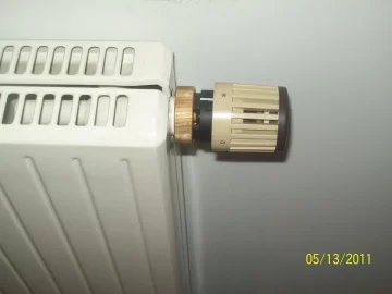

Does anyone have experiance with TRV's ?Am looking for recomendations on pro's and con's of different makes or models
Thanks Thomas

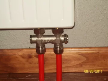

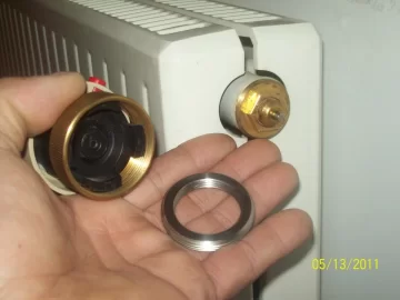

Since you have one loop and not a home run manifold you may need a bypass for each rad so the water can go to the next rad even if the trv is closed. I included a picture of the bypass on my rads. I was going to take a pic of the trv but my batteries are dead. They come with different size threads so be sure to get ones the will fit. I didn't realize there were different sizes and got the wrong size. I had a friend make me some addapters at a machine shop. I have honeywell and they work good.

If you are feeding off a manifold, you do not need a bypass TRV, just an on/off one.

Got my batteries charged a couple more pics.
