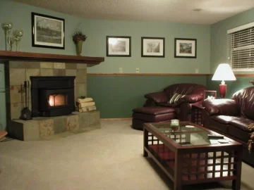

OK, I'm in the dog house. We started looking for a stove in the early spring of 2006. I took down ~10 trees on my property, and have split and stacked about 3 cords so far. After countless hours of research, we bought a 1yr old Lopi Freedom wood insert. We loved the look of it, the size of the firebox, have 2 local dealers nearby (in Northern Massachusetts right on the NH line), and especially like the fact that it extends onto the hearth so you can have a cooktop surface.
Well guess what? It is supposed to be installed next week, and I JUST noticed that our hearth is 3inches too narrow
We need 16" plus 7" that the stove extends on the hearth (23"), but only have a little over 20" of hearth. My options are to:
1. Mount it flush. Then we lose the cooktop and have to purchase a flush mount kit.
2. Extend the hearth. issues here are cost, and whether the new brick can match the old.
Has anyone here encountered this and had to extend their Hearth? I saw a single ref to this in my forum searches. I'm really interested in the cost and matching the existing brick (nothing fancy, standard red brick with a carpet running up to the base).
