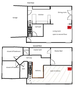

I am heating 1600sqft of a 1930sqft home with the stove, two upstairs bedrooms are closed off. The downstairs is a relativly open floorplan with the kitchen/dininngroom seperated by a 15 wide arch from the living room, The livingroom has two story celings and the kitchen/dinningroom is single story. The stove is right next to said arch on the livingroom side, allowing heat to flow easily into the dinningroom (indirectly) keeping that room within 1 degrees of the living room and the master upstairs within 2 degrees of the living room. Diagram attached.
I have the thermastat prob on the diningroom side of the arch, about 3 feet from the stove but behind a wall for a more acurate reading. I have been using Room Temp auto up until today. I just switched over to room temp manual because last night the stove when into shutdown and finished its exaust cycle, almost 10 seconds after final shut down was when the auto sequence started back up! No point in making the stove cycle so often for no reason so now that it is 0f outside i have it on manual mode. Room temp has been great, it keeps right at the desired setpoint and with the fan on high the heat moves around the 1600 sqft well. I will experiment with fan on medium now that it is consistantly cold and the stove isnt cycling. But really high isnt THAT loud. I do turn the TV up a notch or two. But it is quieter than a box fan on medium.
