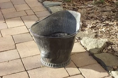

This is the amount of creosote that came out of my 12' stack, 6" diameter, from Thanksgiving to Valentines day. I usually clean the flue on a Holiday schedule, but I skipped Christmas this year because I am burning a more seasoned supply of wood. This pile does NOT include the creosote I scraped off the chimney cap, which was substantial and certainly would have added 2" more to the level of this heap inside the ash bucket. The cap is black, for sure, but it's clean now. But the top is still a shiny stainless color.
So remember, after burning for ten years with the same stove, I know what to expect. I realize that each year I have a different supply of wood, different moisture content, different variety of tree. So I know to expect the somewhat unexpected. Keep an eye on things. Listen to the draft, and inspect your cap. The cap is going to be the coldest point of your stack. Once the buildup becomes noticeable, you are on borrowed time.
