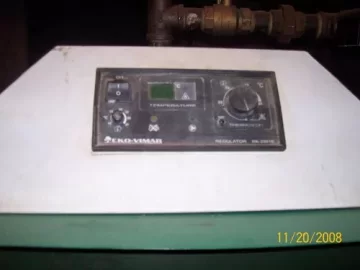

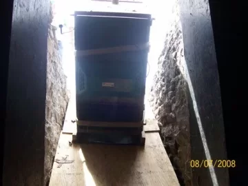

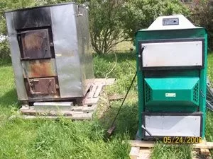

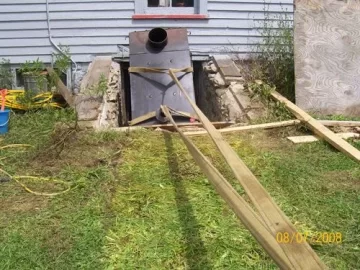

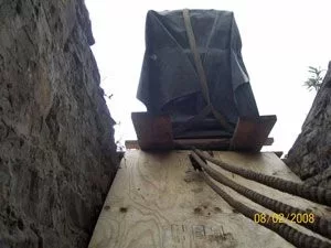

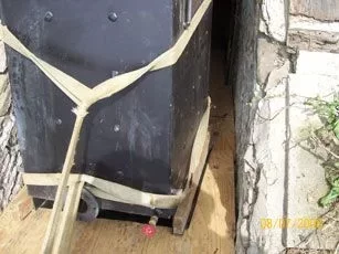

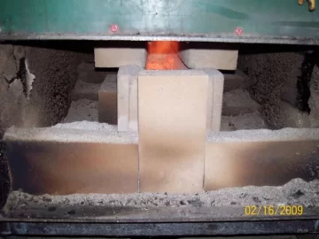

Hello again to all I've been away from the site for a little while. Sdrob your right I do have a 60 standard, and continue to run it full time.. I am happier with my EKO this year than I've ever been, like you, I continue to make trial and error changes to attempt to maximize my operation boiler and piping. I dug around and decided to post some old pics in no particular order, hope you don't mind.

Good to hear from you again. The new refractory blocks look really cool and I can't wait to hear how they work out for you. My blocks are still in really good shape so I wont replace them yet but I'm thinking about placing some firebrick on top of them to make them look like the new ones.
P.S. Old boiler porn is still good boiler porn ;-P
LOL boiler porn.. To be honest with you I have not replaced my factory U blocks either although 1 is bkoken in half its still very useable.. I was trying some extra fire brick in the bottom chamber but I found myself right back to the basic approach. Standard fire brick in the rear stood up on end, 1 factory U block, a standard firebrick lieing down in between the 2 U shaped blocks( this leaves a gap between the U shape blocks in between the nozzles), the second U block, then a standard brick standing on end in front tight to the door which leaves a good gap at the front. So from the front to the back vertical brick,U block,horizontal brick,U block, vertical brick.
My confusion. For some reason I was thinking that you were the one who had purchased the new blocks. I went back and looked and it was bulldogAcres who posted earlier that had bought them.
I did toy with several setups.. But only using extra fire brick..I tried gettin fancy but I had to go back to the basics..
